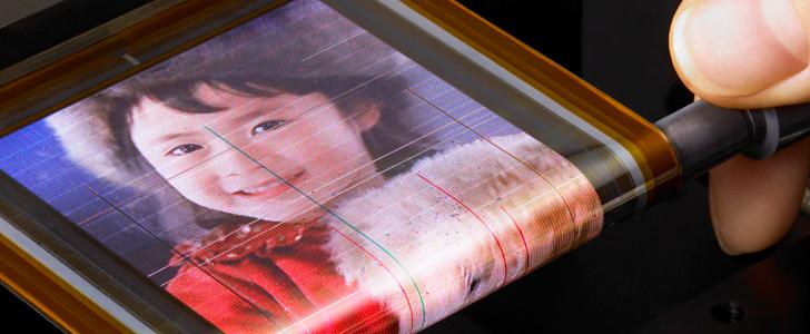

Drauf hat HolgerS gewartet! Ein OLED Display zum Aufwickeln und Dehnen. Bald passt seine Lumix TX7 II in die Hosentasche!
Specification of the OTFT
organic semiconductor : peri-Xanthenoxanthene(PXX) derivative
hole mobility : 0.4 cm2/Vs
current on/off ratio : 106
channel length : 5μm
threshold voltage : -5V
Specification of the rollable OTFT-driven OLED display
size of a panel : 4.1 inch wide
number of pixels : 432 x 240 x RGB pixels
size of a pixel : 210μm x 210μm
resolution : 121 ppi (pixels per inch)
number of colors : 16,777,216
peak luminance : >100 cd/m2
contrast ratio : >1000:1
minimum bending radius : 4 mm
thickness of a panel : 80μm
